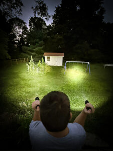

How does that translate for real-world use? The ProTac HP throws a more concentrated beam farther downrange at a distance of 583 meters. That’s more than double the 2.0’s more diffused range of 262 meters. In side-by-side backyard testing, the difference was unmistakable: the HP’s beam cut farther and harder. What’s more, the more powerful 2.0 HP’s runtime on low is six hours longer.

When I finally put the Streamlight ProTac 2.0 HP to the test, the difference as compared to the original ProTac 2.0 was impressive. Its 85,000-candela output provides increased reach and intensity. And I much preferred the tighter and brighter beam the HP produces.
