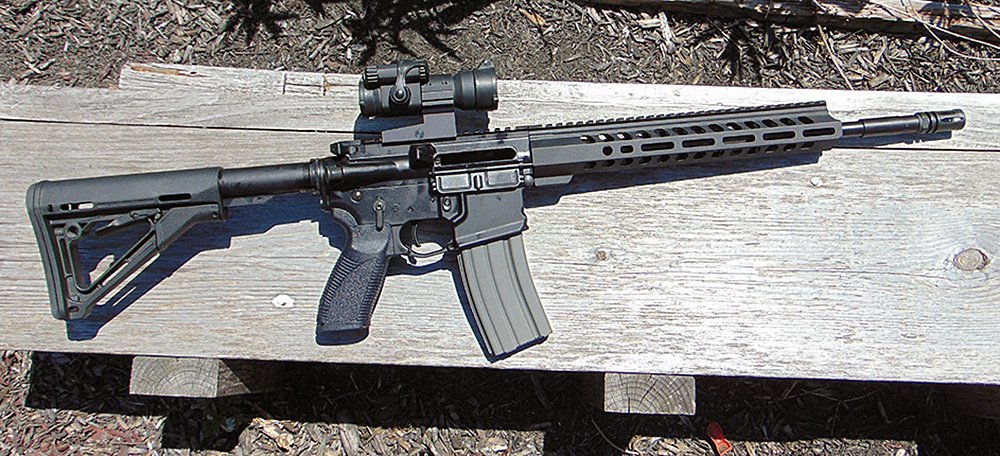

There are a few important details I want to point out before discussing shooting and handling the Caracal CAR814 A2 Patrol 16-inch rifle. The first of which is the trigger and trigger guard.
Enhanced Trigger and Trigger Guard
Caracal uses the newer rounded-style AR-15 trigger guard, which provides more room for shooters with larger fingers or for those working in cold environments while wearing gloves. The larger trigger guard is ideal for law enforcement officers or civilians who live in, work in or travel through places where snow and cold weather are serious issues.
The trigger is an EDT Hiperfire Sharp Shooter, and it is beyond superb. Caracal lists the pull weight at 5.5 pounds, but my Wheeler Engineering trigger pull gauge registered a crisp 5 pounds, 0.6 ounces with no take-up or slack. It is probably the best and crispest AR-15 trigger system I have tested in years.
With the right optic and ammunition, that trigger makes the Caracal capable of serving as an intermediate-range perimeter rifle or compact precision rifle inside 100 yards.
Storage Grip
The Caracal pistol grip features a drop-open compartment in its base for storing small items like spare optic, laser or light batteries. It takes a small flat-blade screwdriver tip to open it. Once opened, the bottom cover swings down on a rear hinge.
It is a vast improvement over the old rubber A2 grip plugs from more than a decade ago that fit into the open space of a military AR pistol grip for the same purpose. The Caracal base is much more secure and is not easily dislodged.
Weight and Handling
The Caracal’s 6.4-pound weight is pretty standard for an M4-type carbine. By comparison, it is 1.8 pounds lighter than a full-size AR-15 rifle such as Springfield’s Mil-Spec SA-16.
That may not sound like much, but the difference matters when standing on post, moving through the woods or hiking rough country over long distances. The shorter overall length and lighter weight are part of what make M4-style carbines so practical.
Ambidextrous Safety
Ambidextrous safeties on AR-15/M16 rifles are brilliant, long overdue and becoming a more universal standard. This and other upgrades to accommodate left-handed military personnel and law enforcement officers are also overdue.
I can tell you it would have been a handy fire-control setup to have when I was the lead firearms instructor at my sheriff’s office. It would have made AR-15 qualification courses much easier, especially during portions where deputies had to switch the rifle to the left shoulder. While we only had a few left-handed deputies, everyone had to learn to work from the support side. An ambidextrous safety makes that easier on the range and in the field.
Magpul CTR Stock
The Caracal’s buttstock is a standard adjustable Magpul CTR carbine stock with multiple adjustment points and a locking lever for when shooters find the position that’s “just right.”
If you have never used one, unlocking the Magpul stock for adjustment is just as easy as locking it. Once locked, it feels as solid as a standard buttstock. It is a major improvement over the original M4 stocks, which were flimsy by comparison. Magpul is the only way to go when it comes to M4 carbine stocks.
Factory Magazine
The magazine that came with the Caracal rifle is another nice touch. The website photo shows the rifle with a translucent polymer 30-round magazine inserted in the magazine well. I am not a fan of polymer AR-15 magazines of any brand.
Fortunately, the magazine included with my sample rifle was a 30-round, made-in-USA aluminum Caracal magazine with an orange polymer follower, which makes the magazine easier to identify.
Aluminum magazines insert and drop more smoothly during rapid reloads than polymer magazines due to lower friction. Aluminum AR-15 magazines, especially straight 20-round magazines, tend to drop free more easily when the magazine release is pressed and are among the fastest reloads available.
One Upgrade I Would Like to See
One thing I would like to see Caracal include from the factory is a set of flip-up backup iron sights, such as those from XS. I do not believe that would seriously raise the MSRP.
The owner could use them for initial testing while deciding on an optic, but more importantly, they would serve as emergency sights if the optic were damaged or went down.
Range Testing the Caracal CAR814
I mounted my original Aimpoint Comp M2 Red Dot sight obtained in 2005 on the Caracal for testing the rifle. Though not ideal for a defensive rifle today, it has the easiest mounting system and always seems to be right on target regardless of the AR-15 I use. I went to my former chief’s range to test the Caracal Patrol and let him get a feel for it as well.
I loaded it with MagTech First Defense Tactical 5.56×45 55 grain Ball ammo and we backed off to 50 feet. To check the zero, we fired from an unsupported standing position at paper. We managed a six-shot group in the top corner of the target that measured 1.5 inches. Firing nine more rounds at the center of the target, I managed a six-round cluster in a 2-inch group, with two flyers opening it up to 3 ¼ inches.
After our initial shots, my former chief had to return to duty, but he felt the Caracal would make an excellent patrol rifle with all the desirable features an officer could ask for and at a reasonable price.
I stayed and backed up to 70 feet, firing a full magazine at the steel silhouette target. With the Aimpoint Comp 2, which doesn’t magnify the image but imposes a dot over similar to a pistol red dot, and the Caracal’s excellent trigger it was easy to ping off the target. There were no malfunctions, cycling was smooth, and recoil was gentle.
Final Thoughts on the Caracal CAR814
While I did not fire a large number of rounds during this test, I did not feel it was necessary. The Caracal CAR814 A2 Patrol Rifle ran smoothly, handled well and proved more than accurate enough for the type of patrol-rifle work it is designed to perform.
The rifle showed no malfunctions during testing. Cycling was smooth, recoil was gentle and there was nothing about its performance that suggested a problem would appear later. For shooters who plan to use the rifle for a specific mission, further load testing would help determine the most precise ammunition for their individual rifle.
Overall, the Caracal CAR814 A2 Patrol Rifle is very well built, nicely finished and made in the USA. It has the handling, trigger quality, practical features and durability I would want in a patrol-ready AR-15. At the listed Guns.com price of $1,350.99, it is an excellent value considering the lifetime quality of service I believe it should provide.
