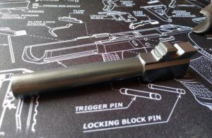

  6. Remove the barrel from the slide by gripping the barrel locking cams located at the back of the barrel. Then lift up. Slide the barrel forward just enough to free it from the slide, then pull it toward the rear of the slide to remove and set aside.
The silver barrel of a Glock 48 9mm semi-automatic pistol lying atop a patterned gun cleaning pad
The barrel from a Glock 48. You can see the barrel locking cams at the raised rearward portion of the barrel.

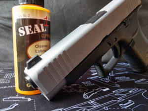

For simplicity’s sake, I’ll outline how I clean my Glocks using SEAL 1, which is non-toxic and multi-purpose. It cuts through carbon buildup, lubricates and protects my guns. Having used SEAL 1 CLP Plus on my Glocks for years, I’m comfortable recommending it.
A two-tone silver and black Glock 48 9mm semi-automatic pistol propped against a yellow bottle of SEAL 1 non-toxic gun cleaning solution
SEAL 1 CLP Plus is the author’s go-to for cleaning and lubricating her Glocks.

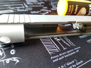

5. Re-wet the brush with lubricant and brush the slide rail cuts to remove residue. Once clean, wipe them off with a dry patch. Again, repeat this process until the patch comes back clean.
Dirty slide rail cuts inside a silver slide of a field-stripped Glock 48 9mm self-defense pistol
The (dirty) slide rail cuts on a Glock 48 can be seen here.

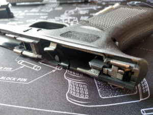

9. For the frame, place drops of lubricant or gun oil on the rear end of the trigger bar where it touches the connector, located at the right rearmost portion of the frame. Spread a drop of lubricant or gun oil along the full length of each slide rail cut.
The polymer lower assembly of a field-stripped Glock 48 9mm semi-automatic pistol, with a view down the darkened magazine well from above while the gun lies on a patterned gun cleaning mat
When your Glock is clean, lubricate the trigger bar where it touches the connector at the right-hand, rearmost portion of the frame.
