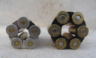

A five round moon clip in .38 Special and a six round moon clip in .45 ACP.
A five-round moon clip in .38 Special and a six-round moon clip in .45 ACP.

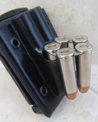

A Blade-Tech Twin Moon Clip Belt Holder showing only one moon clip.
A Blade-Tech Twin Moon Clip Belt Holder showing only one moon clip. The second moon clip is inserted in the slot above the moon clip shown for a total of two.
