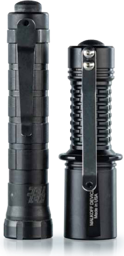

LITTLE BUDDIES: One- and two-cell lights, like these from KelTec and Malkoff, show just how compact modern tactical lights can be.

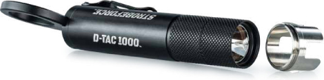

FIGHTING FIT: Certain models, like this one from Strobeforce, feature finger loops and removeable bezels that are designed for striking an attacker.

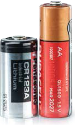

STACKING UP: CR123A cells are expensive but extremely powerful, while standard AA batteries are very affordable but pack less punch.
