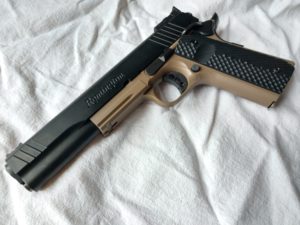

The Remington R1 10mm Hunter FDE is a member of the R1 family of 1911s.

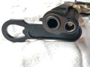

- Depress the recoil spring plug located directly below the muzzle using either your hands or a barrel bushing wrench. As you push the plug inward, rotate the barrel bushing clockwise approximately 1/4 of a full revolution. Take care not to turn the bushing so far that it releases the plug (you want the edge of the bushing to maintain pressure on the plug, holding it in place). This is easiest accomplished with a barrel bushing wrench. Most 1911s will come with one.

The bushing and bushing wrench for a 1911 (pictured: Remington R1 10mm Hunter FDE).

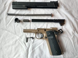

The parts of your 1911 after field-stripping (pictured: Remington R1 10mm Hunter FDE).

Reassemble your 1911 by reversing the aforementioned field-stripping steps.
- Slide the barrel back into the slide.
- Insert the guide rod and recoil spring.
- Align the barrel link and reinstall the slide stop.
- Reinstall the recoil spring plug and rotate the barrel bushing back into place.
- Rack the slide to ensure proper cycling and function.
