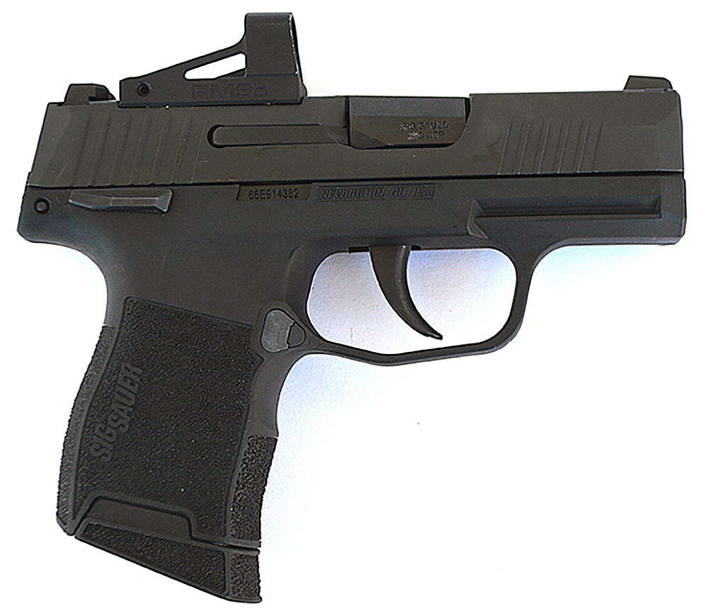

P365 .380 w/ RMSc
The SIG P365 has the same basic design and dimensions as the 9mm P365. It is a polymer-framed, striker-fired pistol. By using identical magazines with a spacer for the shorter cartridge, the .380 P365 maintains a 10-round capacity.
The slide is nicely contoured and fitted with SIGLITE night sights. Later options are also optics-ready. At 15.7 ounces, the .380 is marginally lighter than the 17.8-ounce 9mm version. In most applications, the difference in weight isn’t noticeable. The .380 ACP P365 fits standard P365 holsters.
Ergonomics are good. The pistol sits low in the hand and should fit most hands well. Trigger action is smooth with a clean break. The P365 is available with a manual safety or with no safety.

The .380 P365 ships with SIGLITE tritium sights. The front sight draws your eye to the target. However, if this will be your everyday carry gun, I recommend adding a carry optic. I chose the RMSc from Shield Sights. This service-grade optic has excellent features and low mount. It was easy to install and zero.

Adding the Shield RMSc optic made performance even more impressive. Firing with both eyes open, I was able to run through targets quickly, and the pistol proved superbly controllable.

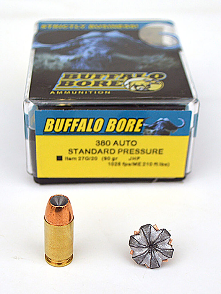

To compare 9mm vs. .380 performance, I used ballistic gelatin testing. The results show the advantage of 9mm while also showing that quality .380 ACP loads offer useful performance.
.380 ACP Ballistic Results
Load Velocity Penetration Expansion
Black Hills Honey Badger 60-grain 1,153 feet per second 12 inches .355 inch
Black Hills 90-grain 889 feet per second 12.5 inches .42 inch
Buffalo Bore 80-grain Barnes X 1,177 feet per second 9.5 inches .70 inch
Buffalo Bore 90-grain JHP 990 feet per second 10 inches .60 inch
Buffalo Bore 90-grain JHP +P 1,060 feet per second 14 inches .60 inch
Buffalo Bore .380 ACP

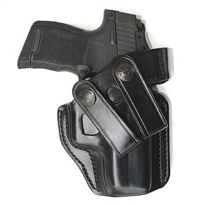

I ordered the new Galco Hawkeye holster for my SIG P365. This is optics-ready premium leather holster is designed to accommodate subcompact handguns with optics. The optics shroud protects the optic from damage and aids in the draw. Dual belt loops cinch the holster and handgun solidly to the belt, providing an excellent balance of speed and weapon retention.
