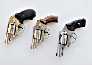

Left to right: concealed-hammer DAO, spurless-hammer DAO and Bodyguard-type with single-action option.

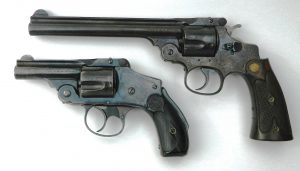

That is the Perfected Double Action (top) and the first Safety Hammerless .38. These basic types — conventional and concealed hammer — have been around for at least 138 years.

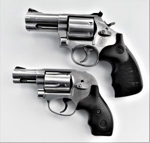

A conventional revolver (top) makes a fine belt gun, while the concealed-hammer revolver (below) is a better choice for pocket carry.

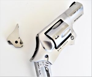

The factory spurless hammer is a flush fit. You cannot modify a conventional hammer to this configuration and maintain reliable ignition.

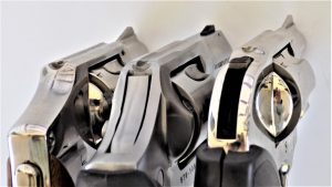

Left to right: semi-concealed-hammer revolver, concealed-hammer revolver and bobbed-hammer revolver.
