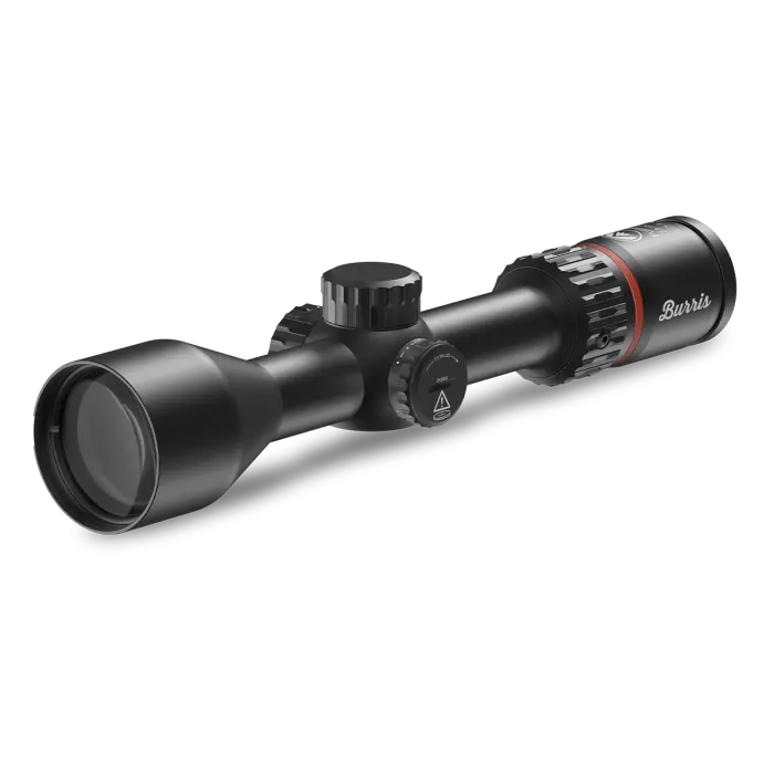

The Fullfield 2.5-10x42mm scope is not a dedicated .22 scope, which is one reason I liked it for Owen’s Ruger 10/22. Burris describes the Fullfield 2.5-10x42mm as a riflescope designed for hunters and shooters who need both adaptability and precision.
That summed up what we needed for Project Appleseed. The 2.5 was precise enough for 25-meter target work but reasonably sized at only 15.4 ounces for Owen at age 12. And he won’t outgrow it as he gets older.
Specifications
Model: Burris Fullfield 2.5-10x42mm, Model 201511
MSRP:
$288
Reticle:
Ballistic E3 Illuminated, red
Magnification:
2.5 x 10
Objective diameter:
42mm
Ocular diameter: 41mm
Focal plane:
Rear focal plane
Field of view:
43 to 11 feet
Adjustment capability:
¼ MOA
Parallax/focus:
Fixed at 100 yards
Length:
10.5 inches
Weight:
15.4 ounces
Battery:
CR2032
Knobs:
Standard capped
Understanding the Burris E3 Illuminate Reticle

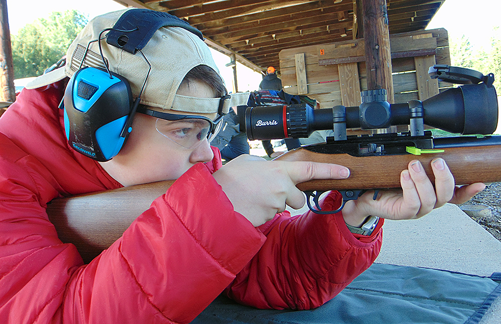

Burris included a set of standard-height scope rings with the Fullfield 2.5-10x42mm scope. I used the Ruger factory mounting Weaver plate to install it on Owen’s 10/22. Once mounted, we took the Ruger to the practice range to zero it at 25 meters using the official Project Appleseed “Redcoat” target.
Owen liked the Burris scope once we had it zeroed. Windage and elevation were easy to adjust with the Burris Knob Synergy system. Burris also offers custom Ballistic Knobs for serious shooters who want to enhance the sight adjustment further.
After the first zeroing session, I noticed one problem. The front end of the scope bell was resting on the folded rear sight of the 10/22.
Rather than risk marring wood or metal with the tools I had on hand, I asked my buddy Mike, an excellent shooter and craftsman extraordinaire to help. He dismounted the scope, tapped out the rear sight and remounted the optic with his usual efficiency.
