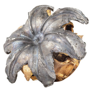

A round of 10mm hollow-point ammunition that has "mushroomed" after impacting a target.
The metal surrounding the cavity of a hollow-point round expands or “mushrooms” out upon impact with flesh or other fluid materials.
Hollow-point ammunition contains a divot in the very tip of the bullet. Upon impact with soft materials — such as flesh — the material fills this cavity and causes the surrounding rim to mushroom out. The standard acceptable expansion is 1.7 times the original diameter of the projectile. So a .45 ACP hollow-point (with an original diameter of 0.451 inches) should expand to at least 0.7667 inches. Some rounds expand to nearly twice the original size, dependent on the design and composition of the projectile and the muzzle velocity when it impacts the target.

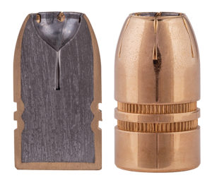

A jacketed 10mm hollow-point bullet showing both the outer copper jacket and a cutaway of the lead, hollow-pointed core.
This Jacketed Hollow-Point (JHP) round involves a copper jacket over a lead core. Notice the hollow cavity in the lead at the tip of the bullet and the serrations at the top of the copper jacket.
