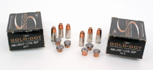

Two black boxes of Speer brand Gold Dor personal protection 9mm handgun ammo, plus six full cartridges with copper hollow-point bullets and nickel casings. Nearby are six flattened bullets.
Weight and velocity significantly impact expansion performance. These two bullets are the same weight. The one on the left is a +P version that travels at higher speed, hence the improved expansion performance. (Photo by Tom McHale)

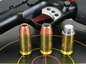

Three rounds of ammo standng atop a target with a handgun lying nearby in the background. The three cartridges have different bullet weights and therefore different velocities.
Is a heavier bullet better? It depends on the job at hand. These 450 SMC loads range from 160 to 230 to 255 grains left to right. (Photo by Tom McHale)
