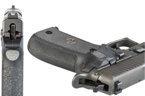

LEFT: Double-Action Only – This Smith & Wesson Bodyguard .380 can only be fired double-action. Its concealed hammer makes it exceptionally easy to carry. RIGHT: DA/SA – A double-action/single-action pistol, like this SIG P226 Legion, operates with a double-action trigger press for the first shot, but subsequent shots are sent with a single-action trigger press.
