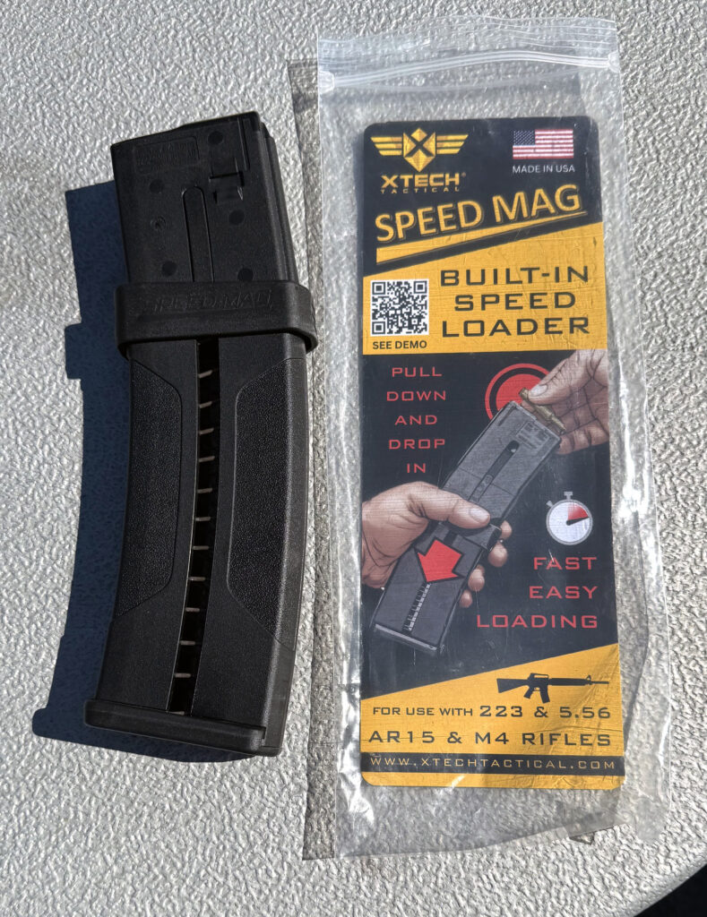

XTECH sent me several samples for testing, and the first product that caught my eye was the XTECH Tactical Speed Mag, a 30-round 5.56mm/.223 AR-15 magazine with a built-in speedloader.

You’ll immediately notice the Speed Mag looks different than a conventional AR-15 magazine. Featuring an all-composite construction, when the magazine is at rest, you will see the follower is connected to an exterior loading ring.
The ring is actually rectangular and wraps around the magazine body, functioning more like a sliding sleeve.
As you pull the sleeve downward, it compresses the magazine spring and lowers the follower, allowing cartridges to be placed into the magazine without pushing them down by hand. XTECH recommends starting with two rounds at a time.
The sleeve has grooves on its narrow ends to give your fingers and thumb a better grip. Resting the magazine base on a hard surface makes it easier to pull the sleeve down and control the loading process.
The design eliminates the need to press individual cartridges downward against increasing spring tension. Instead, the loading hand simply places the rounds into the magazine while the other hand pulls the sleeve down.

A long, curved slot runs down both sides of the magazine body, allowing you to see the magazine spring and the position of the cartridges inside. This slot is why this particular magazine won’t work well for duty, as it can be easily plugged by mud, sand, snow, ice or dirt.
The slots also allow you to see how the cartridges are stacked and get a reasonable idea of how many rounds remain.

The Speed Mag comes packaged in a clear zip-lock bag with an information card containing operating directions. While the magazine is easy to use, you do need to pay at least a little attention to those instructions.
